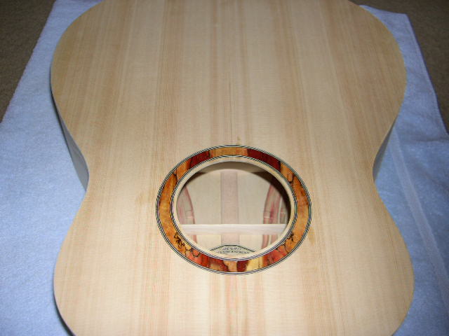

Next a shot of the top, which is striped Engelmann from Larry Stamm of British Columbia:
A close-up of the rosette, which has been painted with super glue to stabilize it:

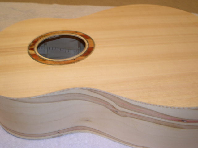

Finally a shot of the side. It will also have Bloodwood bindings, with blk/Bloodwood/blk side purflings to match the center stripe.
You can see the little beetle holes all over the guitar needing to be filled. I can advertise this as already having been attacked by bugs, so no worries for the future.

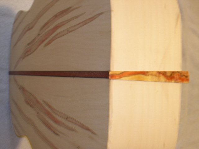

Oh yes, there was enough of the rosette stock left over to cut a tail wedge. It's not inlayed yet, but let me include a shot showing the idea. I normally like to keep the tail wedge the same material as the binding, but I just couldn't pass this up:

That is one beautiful piece of work. The rosette and tail wedge are just gorgeous. What did you paint them with?

They are "painted" with a thin coat of super glue. I did this when carving the top braces, and noticed that a bit of the rosette was starting to erode (!) due to the handling. Some of that spalt is just SO soft.
The CA was wiped on to help solidify the remaining wood.
It sort of makes the color / figure jump out, doesn't it?

How are you planning to fill the bug-holes? Enough of that bloodwood to
dowel them?
PostPosted: Sun Nov 13, 2005 11:17 am
Steve, you cleated all the holes didn't you? I think I would leave the holes for their uniqueness and drop fill before finish. This is going to be an amazing guitar. I also bought some of this from the zootman, but after seeing your work, I think I'll leave it in the back of the wood stash for at least 10 years.

Brian: I'll use more of the same. I mean same as the back stripe, so it'll have Bloodwood bindings with blk / Bloodwood / blk purfling on the sides and back.
Charlie and Don-- yes, the holes were cleated on the inside, and the idea was to fill the outside with some black superglue. Or something like that. My thinking was like yours, to go ahead and accentuate the holes, and make them a design feature. But Don, take your wood out from the stash and go ahead and work it. It bends easily, and looks undeniably cool. Plus, it's odd enough that it might take some time to find a customer....
